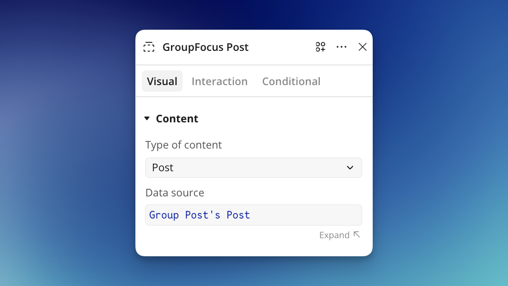

Set the Type of content and Data source on the group focus, and its child elements can reference the data using Parent group's expressions.
Group focus element property editor with Type of content set to Post and Data source set to Group Post's Post.
Setting the data source on a group focus makes it load its data as soon as the group is shown.
