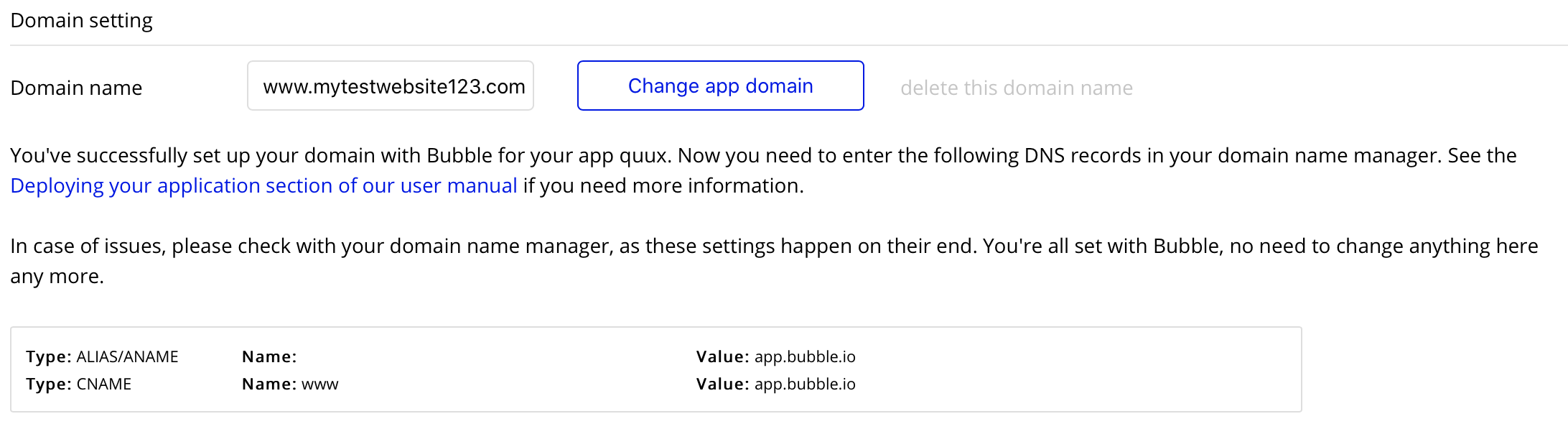

To set up the domain with your app, enter the domain in the input box in the Domain Tab and click 'Set up this domain'. Once you've done this, Bubble will provide the DNS records that you should enter on the registrar's end.
Once you have the DNS from Bubble, you do not have any setting to modify in Bubble. You should instead head to the registrar service that you use to manage your domain and find the DNS section (or DNS Zone File). Once you have found that section, delete existing A records whose name is '' (empty) and 'www', and instead add the records as indicated above. (Some registrars use '@' to refer to the empty domain.)

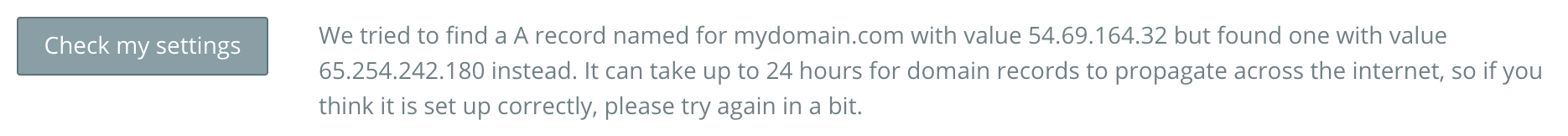

After setting up the DNS records, the new settings need to propagate across the internet. This can take up to 24 hours, but usually you should see some results after 2-4 hours. Bubble lets you check the success of the operation below the records, and you can check the process by clicking on the 'Check my settings' button.

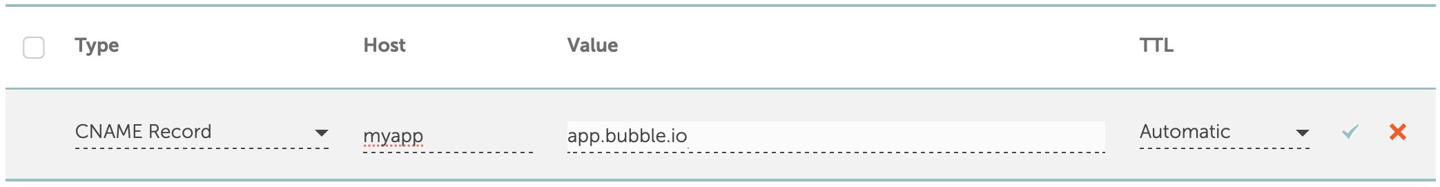

If you already are using a domain and would like to use a subdomain to point to your Bubble app (for instance, app.yourdomain.com), you can do this by simply using this as the domain in the input box. The DNS records will be different, but the process of entering them in your registrar service is similar as above.

When you choose your custom domain, Bubble will instruct you to create four records at your registrar. The records will be of the form
These are provided for redundancy, but in most cases your custom domain will work identically with either or both, so long as you have at least one record for the bare domain and one for www.

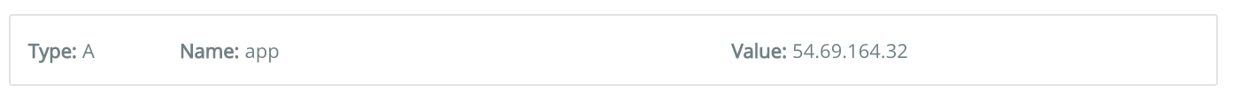

(app.example.com)
If your custom domain is of the form app.example.com, you can register the custom domain in your Bubble app, in Settings -> Domain.
Bubble will instruct you to create two records at your registrar. The records will be of the form
These are provided for redundancy, but in most cases your custom domain will work identically with either or both.
You can enter these at your registrar:

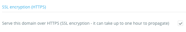

If you created your account after October 2019, SSL is mandatory. If you are on a Legacy (pre-2019) Personal Plan and higher, you can activate SSL encryption on your custom domain. Note that all apps hosted on a bubbleapps.io subdomain also offer SSL support on all plans. Using SSL encryption lets you guarantee to your users that no one can intercept traffic between them and your site, and protects their private information. SSL encryption also helps with search engine rankings, and can be required to use some features (access to geolocation on Chrome, using Stripe payments, etc.).
Setting up SSL
Once you have properly configured your domain and that Bubble has validated the A records, you can start the process. To have SSL activated on your site, enable the checkbox.
This change can take up to one hour to propagate. For customers using Cloudflare, SSL is mandatory.
