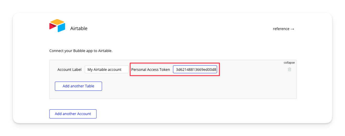

Install the Airtable Plugin in the Plugins tab of the editor. Click “Add another Account” and fill out your Account Label and Personal Access Token.
The Account Label can be a label of your choosing.

Add the token to the plugin
After you have created the token, you can add it to the plugin settings. Copy the string and paste it into the Personal Access Token field in the plugin settings:
