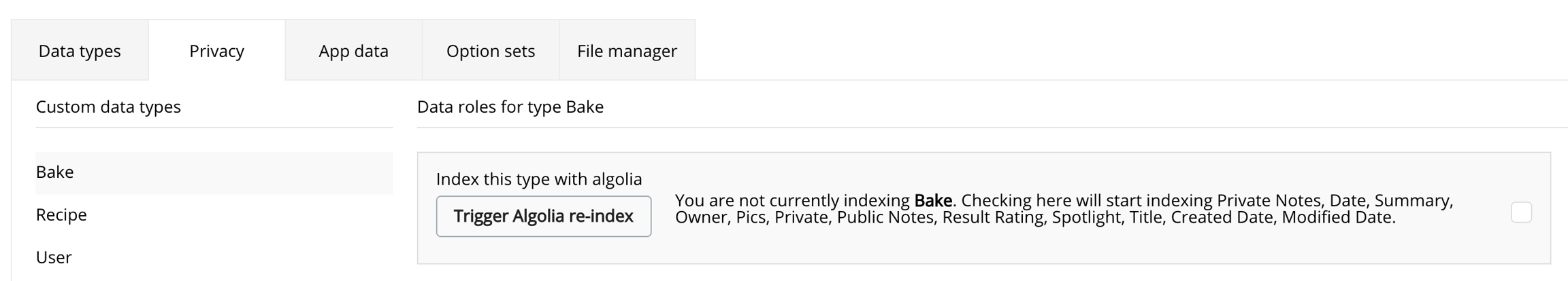

After keys have been added, in the Privacy tab for every data type, you’ll see the option to index that type with Algolia.
![](https://s3.amazonaws.com/appforest_uf/f1585840930894x345364301566459140/algolia_privacy_tab.png)
If a data type is indexed to Algolia, Bubble will send **all public fields** to Algolia, i.e. the fields that are visible via search in the “Everyone else (default permissions)” Privacy rule. Bubble will automatically create the necessary indexes in Algolia for you - **you should not rename those indexes**.
In addition, make sure that the data type being indexed has **"Find this in searches"** under the "Everyone else" permission checked.

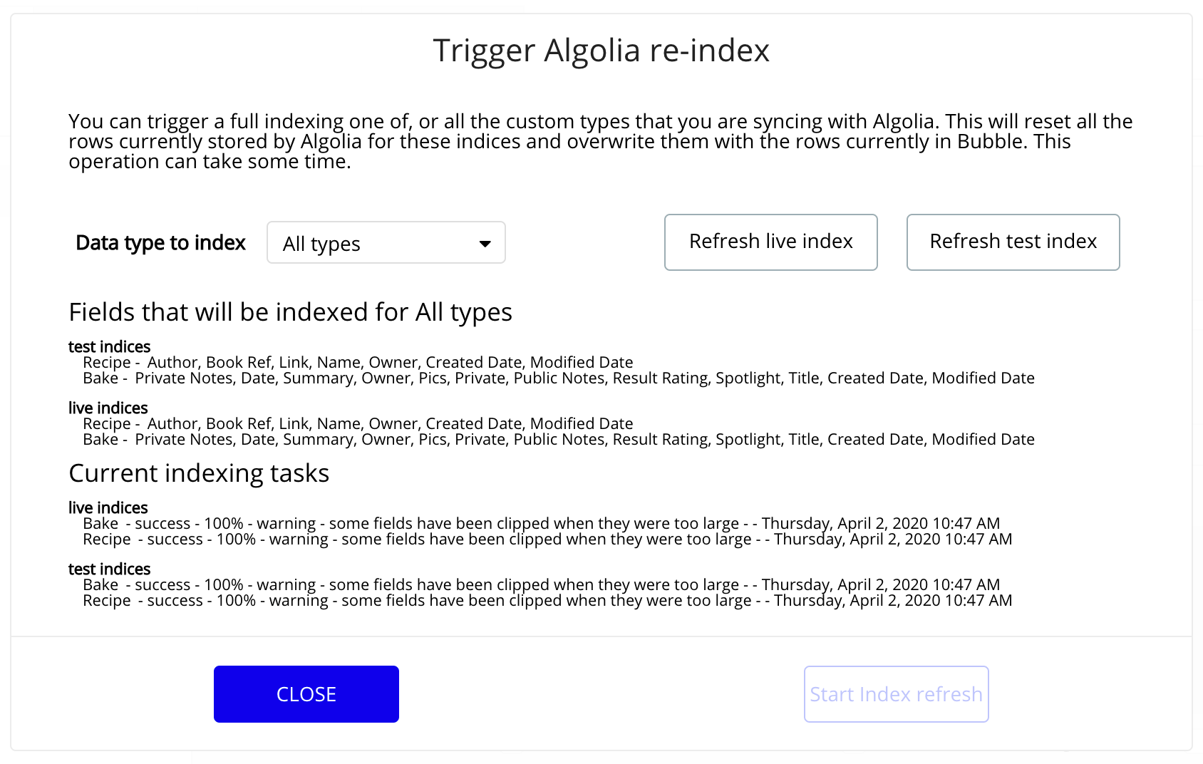

After you toggle a data type to be indexed by Algolia (checkbox on the right), you will probably want to trigger an indexing of all the things of that type. You can do so in the modal accessed at the top of the Privacy page for any indexed type.
![](https://s3.amazonaws.com/appforest_uf/f1585840975838x691412509932716700/algolia_indexing_modal.png)
You can choose to trigger a full indexing of all indexed types or just one type, and you can choose to do this for your Development database ("test"), Live database, or both. Note that doing a full indexing could take noticeable capacity over a period of time (depending on how many things there are), so the recommendation is to trigger a full indexing once after adjusting all your data types’ settings, and to do it at non-peak hours. Behind-the-scenes, the full indexing runs the same process as a large CSV data export, so you can actually see the status of these tasks in App Data > Export.
