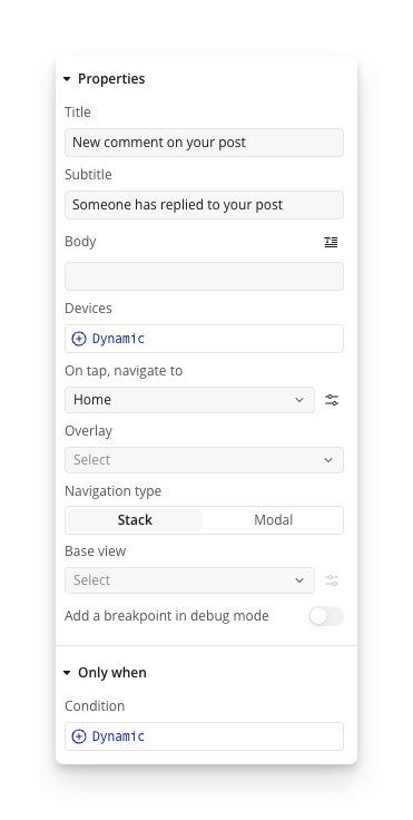

### Sending push notifications
Once the user has given permission, you can send push notifications with the **Send push notification** action, which you'll find in the *Emails and notifications* category.
<figure><img src="https://34394582-files.gitbook.io/~/files/v0/b/gitbook-x-prod.appspot.com/o/spaces%2F-M5sbzwG7CljeZdkntrL%2Fuploads%2FY2DdsUjxTb0P6sAwbkXa%2Fsend-push-notifications.png?alt=media&amp;token=1ac52e55-492f-452b-928e-d508a7bf6e2e" alt="The properties of a Send push notification action, with a title, subtitle, body, devices, tap destination fields, and an Only when condition." width="278"><figcaption><p>The properties of the <strong>Send push notification</strong> action.</p></figcaption></figure>
| Property            | What it does                                                                                                                                             |
| Title               | The main header                                                                                                                                          |
| Subtitle            | The sub-header                                                                                                                                           |
| Body                | The main message                                                                                                                                         |
| Devices             | The [devices](#the-devices-data-type) to send the notification to, from one or more users. To send it to the current user, use `Current User's devices`. |
| On tap, navigate to | The view to open when the user taps the notification. See [Configuring a tap destination](#configuring-a-tap-destination).                               |
Your app icon is shown in the notification, and you can't change it for individual notifications. The properties work the same way on iOS and Android, and the notification looks much the same on both.

#### Example: deep linking to a detail view
A common use is telling a user about a new comment and taking them straight to the post:
{% stepper %}
{% step %}
#### Create the backend workflow
Create a backend workflow that runs when a new comment is created, and add the **Send push notification** action.
{% endstep %}
{% step %}
#### Write the notification
Set the title and body, such as *New comment on your post*.
{% endstep %}
{% step %}
#### Set the destination
In *On tap, navigate to*, pick your *post\_detail* view, and set *Navigation type* to *Stack*.
{% endstep %}
{% step %}
#### Set the base view
Set *Base view* to your main feed view, so the back button takes the user to the feed.
{% endstep %}
{% step %}
#### Pass the post
In *View parameters*, pass the post's unique ID to the destination view's property.
{% endstep %}
{% endstepper %}
When the user taps the notification, they land on the post. Tapping back takes them to the feed.
